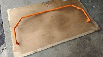

No yellow, black yes if I had the spray can available. I had purchased a can of bright gloss orange paint when I pulled off the rear sway bar from my daily, cleaned off the grime and surface rust and painted it that colour (didn't want to do the normal red, black). So that's the colour I had and honestly I actually thought the SC cover would hide it completely but it didn't so Oh well.......................
Nothing wrong with a little colour splash under there, especially the enormous amount of time I spent fabbing the friggin thing LOL I guess I wanted it to stand out a bit.

No yellow, black yes if I had the spray can available. I had purchased a can of bright orange paint when I pulled off the rear sway bar from my daily, cleaned off the grime and surface rust and painted it that colour (didn't want to do the normal red, black). So that's the colour I had and honestly I actually thought the SC cover would hide it completely but it didn't so Oh well.......................
Still looks good. You did a good job. Paint the air intake cover the same and it will all tie together. :angelic:
