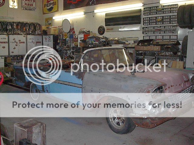

In the fall of 1975 I bought a 58 Impala hardtop down in Beechy
Saskatchewan ( car #1 story ). The owner had a bunch of cars but all were mostly
Ford family

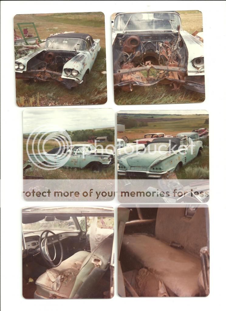

and chev's he didn't care for. He also showed me a rough 58 convertible
out in the field . It sat in a pothole that filled with water every
spring. The car looked like it hit a pole dead smack center. It was a
old 60's custom job. The body was dechromed, had a 394 Olds and
automatic in it, shaved trunk lid , custom flat lens tail lights and a front seat I
think
was maybe 56 Buick. Terribly weathered and just a poor reflection of what
once was a gorgeous car. He wanted $50 for it , I said no. I was so
happy I was dragging home the hardtop for $650 that the convertible was
just not in my " some day " line of thinking ( yet ). I did up the
hardtop quickly and was driving my dream car. But after getting

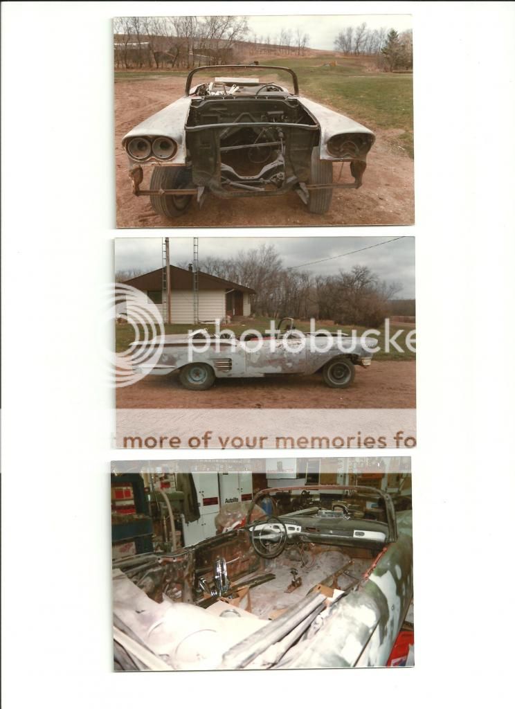

In 1983 I started the 4 year project. I only work on stuff in the
winter time so I spent many many long days and nights in the shop. I'll
never forget the first day I tried to get it into the shop. I'm dragging
it from the prairie out back and the rear end won't turn, what the heck ?

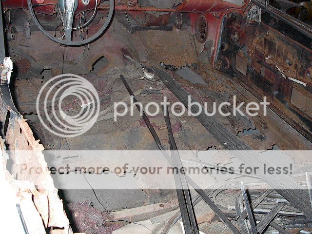

it turned before ?? Well after I get it in the shop and lift it up on
the hoist, I find the rear end is frozen solid....ahh !! makes sense now,
the car sat in water every spring so the diff filled up and now it froze .
The car from factory was a black on black 283 powerglide , 3 piece
bumper car and had american tags on it. Brackets were mickymouse welded
in front to hold the Olds 394, a hole was torched in the hump for a stick
shift , the front hit a pole and was caved in but the frame looked ok.
Surprisingly the only real rust was the front floors and trunk floor.
There were alot of little dents on the car, a few bullet holes, and mud everywhere.
The body was dechromed and every molding hole was filled with window screen behind
and mud on top. I wanted all the chrome back on cause the 58 had nice
stainless I thought. If I remember right there were over a hundred holes
I had to open up. The front sheet metal was shot so I used better stuff
from other parts cars. With a feather edger I stripped the body down to
the steel . I wanted some old school custom tricks so my plan included
shaving the door handles and trunk lid. In the bottom of rear quarters I
frenched in 54 Buick port holes to simulate exhaust outlets. On top of
the left rear fender I tunnelled in twin aerials. All these body mods
were a challenge for me cause I never did this before, so I was very slow
at it. Plus I only had a acetylene torch to weld with so a rag and cold
pail of water was used alot to prevent warping, but I did it somehow.
The front floors I replaced with one from a parts car and the trunk pan I
made up as I didn't have a good one. I think that first year all I did
was do bodywork. I'm not good enough to paint so I left the final
blocking and paint for a good friend of mine which was done much later
down the road. I restored the frame, replace the complete diff ,
installed a factory style power steering ram system and changed the front
spindles and drums to a 62 pontiac , so I had the bottom pretty well
done.

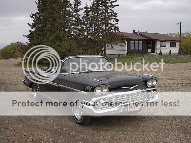

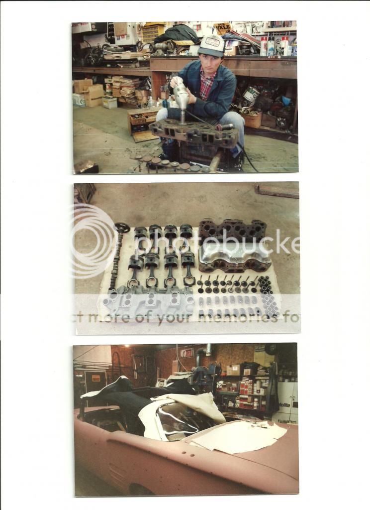

I had a small block 350 from a truck so that is what I decided to use in
front of a original cast powerglide. I rebuilt the 350 myself including
grinding the valves. The good tranny I had was out of a 58 with a 6 cyl
so it didn't bolt up, but I had a junked V8 tranny so I swapped out the
bell housing. I wanted stick shift so plan was using 66 chev buckets
but console had to be narrow cause of room, so a 64 chev was perfect and
I always liked the T-bar shifter. Making the linkage was not easy as the
way the arm is on a cast glide it took some figuring to make it work.

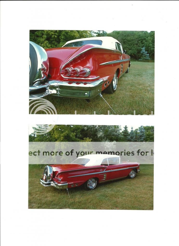

The car came with 6 custom made flat red lenses but I thought old school
59 Cadillac would look better and actually the caddy bezels fit nicely in
the 58 housing so I matched them up. I wanted a different grill too.
After looking through old hotrod magazines I seen a popular choice back
then was 50's Desoto or 53-54 chev. Desoto parts I did not have or even
had access to around here. But after looking at a 53 chev car, I could
tell the " V " angle looked about same as the 58, only the 53 was much
narrower. So I found enough from 4 '53 grills to extend to the width I
needed , plus use 9 bullets. It turned out perfect. The trunk
solenoid was easy to do but the doors I wanted a unique secure entry
system and not just hide a button in a molding or someplace on the body
to open the doors. I only filled the door handles but left the lock
location. What I did was use the electric tail gate window lock from a 59
pontiac wagon. It looks excactly like a door lock and it fit in the hole
perfect. But what is neat is that I wired it so that when you turn to
the right it opens the drivers door, turn to the left and " click " it

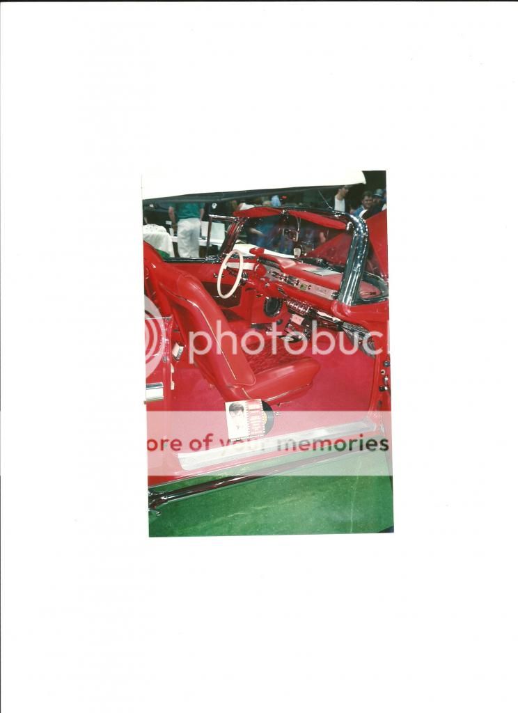

open the passenger door. So I had a stock looking lock on the outside
with the magic and security I wanted. On the console I mounted a power
window switch so toggle it right then pass door opens, toggle left and
drivers opens. I also removed the inside door handles and arm rests and installed
65 Wildcat pull handles.

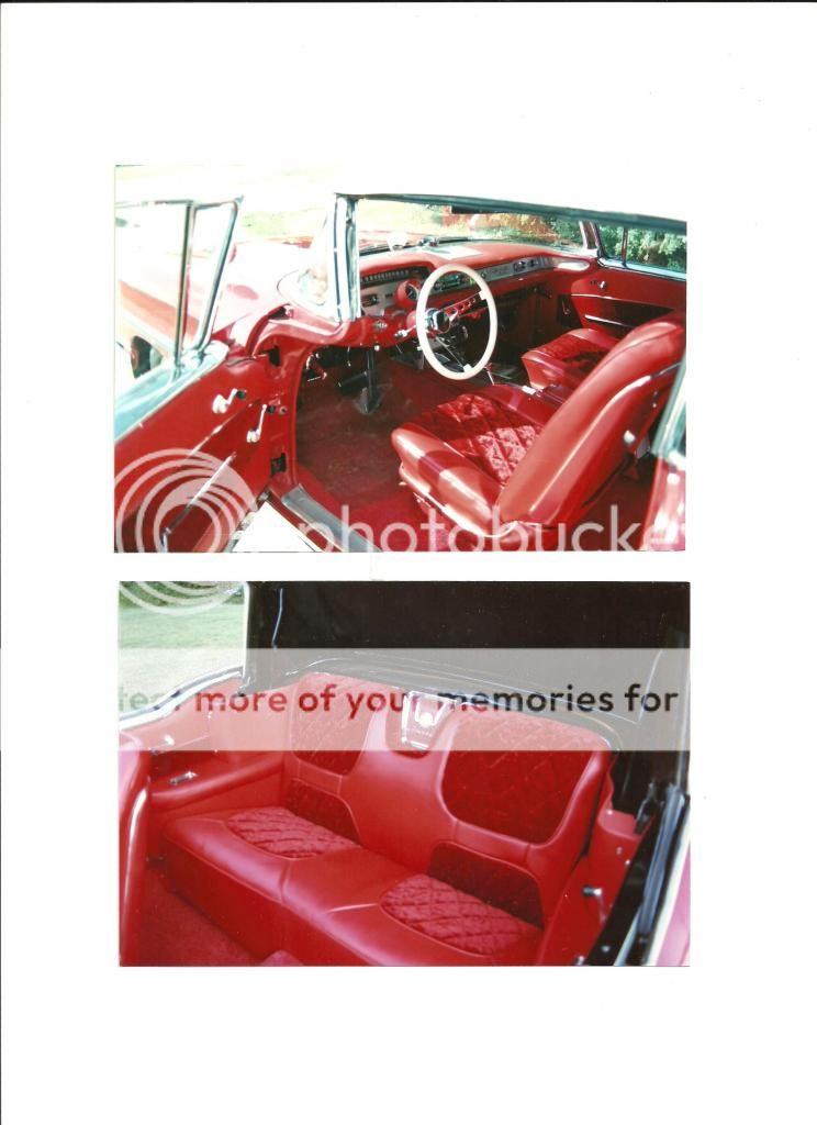

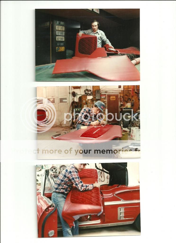

The body moldings I gathered over the years from parts cars. Majority is
stainless steel. I spent alot of time pick and file trying to get them
straight, then polish the supreme out of them. The top I installed
myself and it turned out very good . My mom sewed the seat covers and I
made up the dash ,door panels and cut the carpet out of a house type shag. I
also had most stuff under the hood chrome plated including the inner
fender wells and rad support.

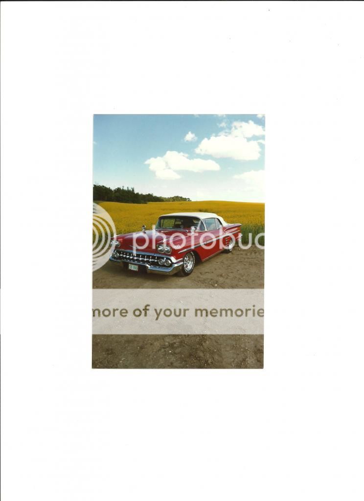

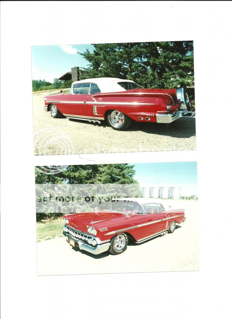

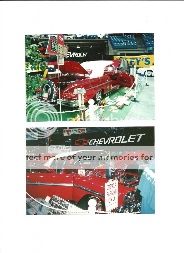

I put the car together and it was ready for its first car show, Draggins in
Saskatoon Easter weekend
1987, the provinces biggest indoor show. So what was to happen now ?
Would my 58 get laughed at and me get thumbs down for wrecking a
valuable car ? I had a decent display also to go with the corner spot
I was given. Well when I pulled in that evening to setup, immediately
the car drew alot of attention from just the guys there. The car was
new and never seen before and totally different to the norm of the
times. 2 days of showing and I could not believe the response. The
before and after pictures, the fact I did almost all the work myself, I
stood there and answered all questions to the public, and honest only
about $3500 to build, people just loved it and no one laughed. Come
award time I was shocked. The car won 5 trophies. Best Custom in the
show, Best Engine , Best Interior , 3rd for my Display, and the
hardest one to win anywhere - The Peoples Choice Award. I was in my
glory. I did a few more shows in the province that year and did well
in all of them.

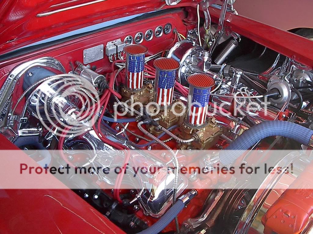

But the story doesn't end yet. The following winter I get another idea
to change the car even more. Why touch a fresh car , but I just had to
do it. You see I originally only wanted a show car, not a driver. My
driver was the 58 hardtop which I used alot back then. But I wanted the
Rag to blow the competition away, and same time show guys that you don't
have to spend mega dollars to look good , and bring back some of the old
school tricks that alot of young guys never seen other than in
magazines. So my plan had 3 changes to make. 1 : swap the diff for a
3:36 posi so that I can put that factory dash plaque on the glove box
that says POSITRACTION . 2 : I had a factory continental kit on a
parts car so that might look OK between those 6 caddy lights . 3 : pull

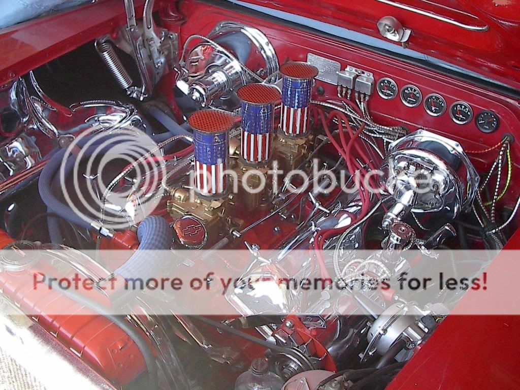

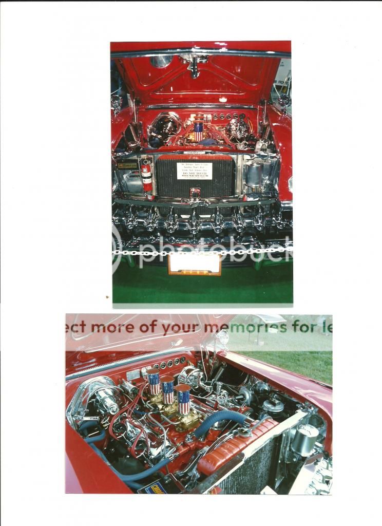

the 350 and stick in the optional 348 tripower. So The diff was easy
to do. The coni-kit I had totally chromed and bolted that on. It is
kinda ugly but maybe not so bad, but it is a factory option and not a
repro kit , rare as can be and the 59 caddy lights work well with it.
I had just recently pulled the dressed up 348 tripower out of my
American Graffitti look alike, so it was going to replace the 350 small
block. Guys I never even took off the hood in the car. I took out the
grill and removed the chrome rad support and radiator. The 350 came out
and the 348 went in no problem, so never had to worry about scratching
the hood or fenders or aligning anything. The 348 looks very much at
home in the 58.

The car is equipped today as follows : 348 tripower 10-1 bored 060
come from a 59 Elcamino Las Vegas junkyard ( $100 ) , cast powerglide,
factory3:36 posi , ps, pb, other factory options : litter bag, tissue
dispenser, hand held spot light , autronic eye, rear speaker, traffic
light viewer, windshield washers, continental kit, electric clock , ash
tray and courtesy lights , engine splash shields. Door handles and
trunk shaved, electric opened only. 54 Buick port holes ( 4 ) , twin tunnelled
aerials one power one dummy, 59 Cadillac tail lights, 68 Dodge red round marker
lights in the doors, 66 Impala buckets driver side 4 way power, 64
Impala console , 45 rpm underdash record player , GM dash compass ,
trunk and underhood lights , 70 Chrysler cruise control , custom 53
chev grill , 62 pontiac drums/spindles , dual fender mirrors,
day/night mirror with map light, inside door arm rests and handles
removed , 65 Wildcat pull handles on doors, lake pipes , detailed trunk , lots of
chroming including fender wells, 5 gauges installed in firewall, Cragar SS 14x7 with
spinners, T-3's, dagger handles on interior air vents , old bullet
style purple lights shining on windshield, headlight visors, and
probably a few more things I can't all remember already.
