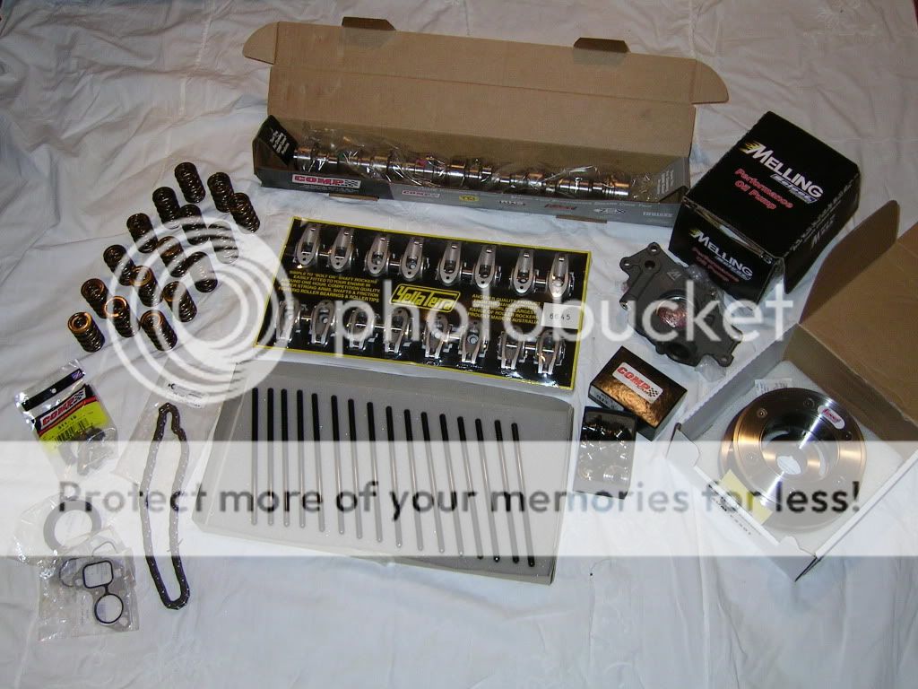

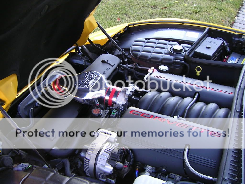

Thought I'd share my latest and biggest mod, an A&A Supercharger with a

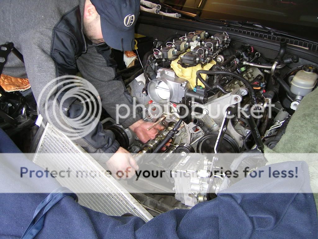

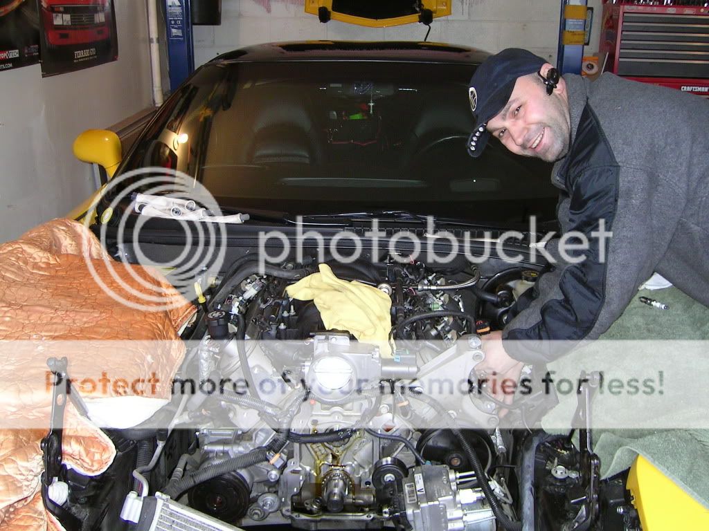

3.8" pulley...My goal was to maintain stock like drivablity with gobs of power available when desired....I enlisted the help of a very good friend to help with the install. (He ended up doing more than he bargained for lol) Maybe you can spot his "Nasty" mug in a few of the pics...
The build also included beefing up the stock valvetrain and a baby cam...
Parts list:
Comp cam 224/228 114 LSA
Yella Terra Rockers
Comp Molly Pushrods
TEA Dual Valve Springs
Kaytec Timing Chain
Summit SFI Pulley
Melling oil pump

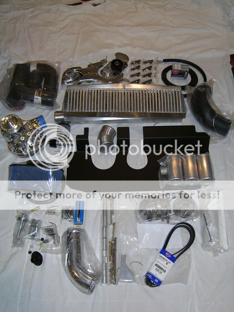

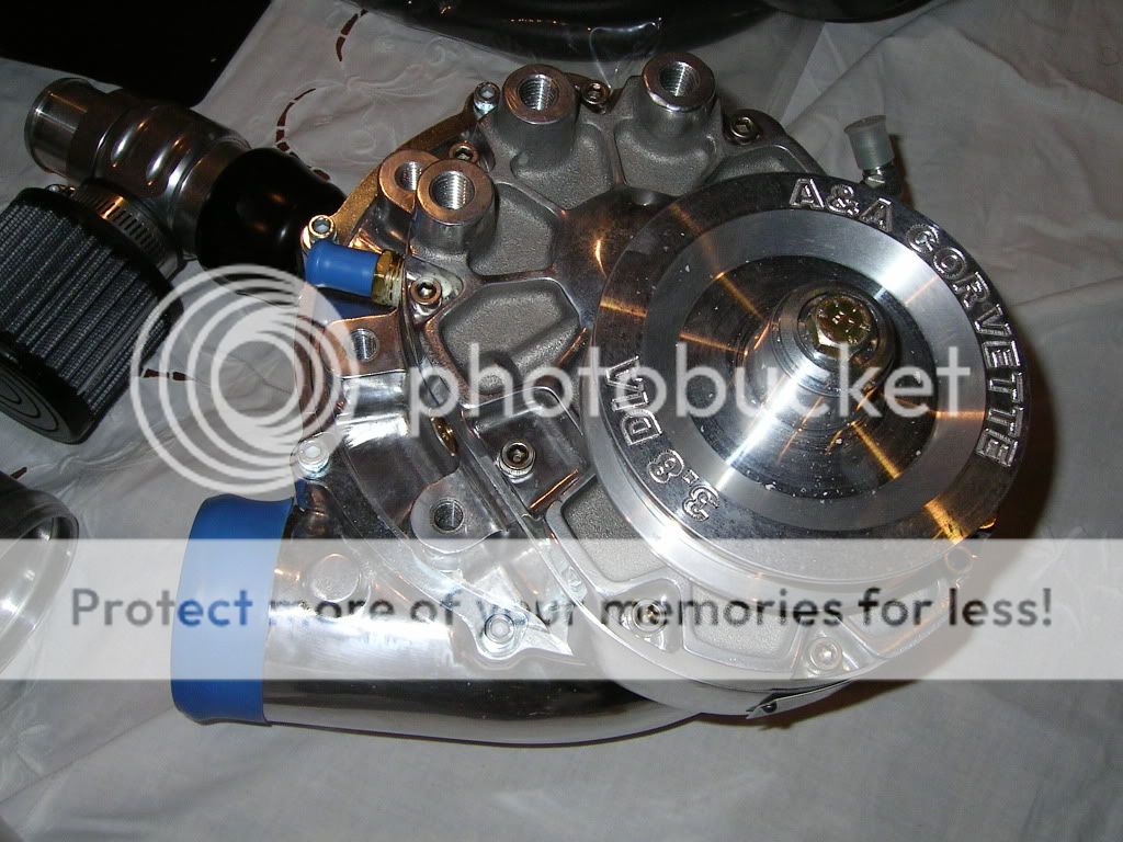

A&A kit
Valvetrain components

Thats one "Nasty" looking helper!!
No turning back now....

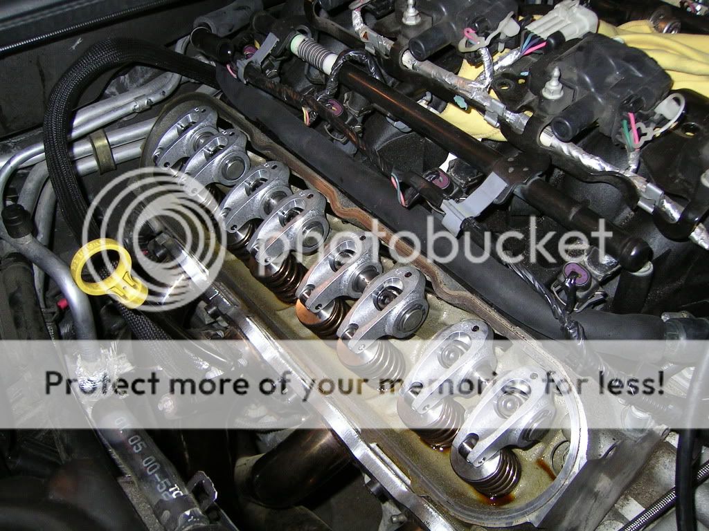

Yella Terras in....

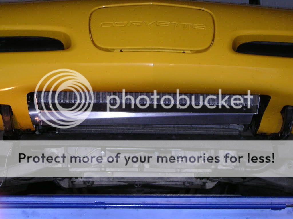

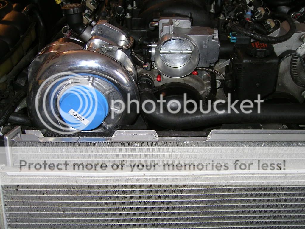

Intercooler lurking below..

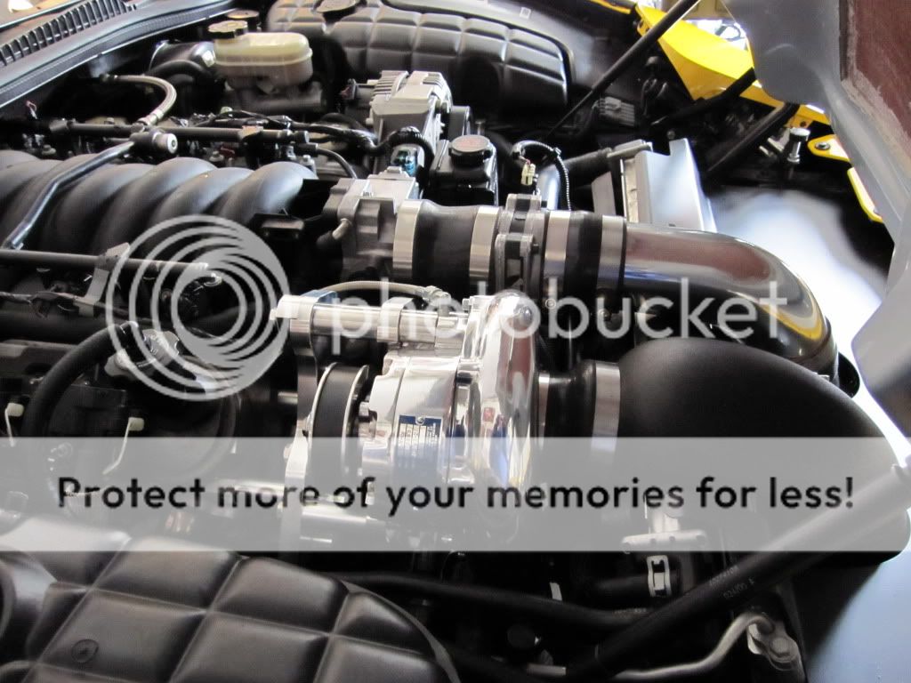

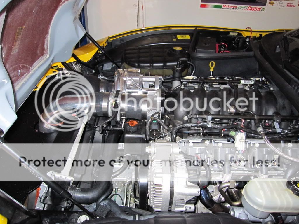

Rad neatly trimmed and Head Unit installed
Install Complete!!
Still needs some cleanup & detailing...
