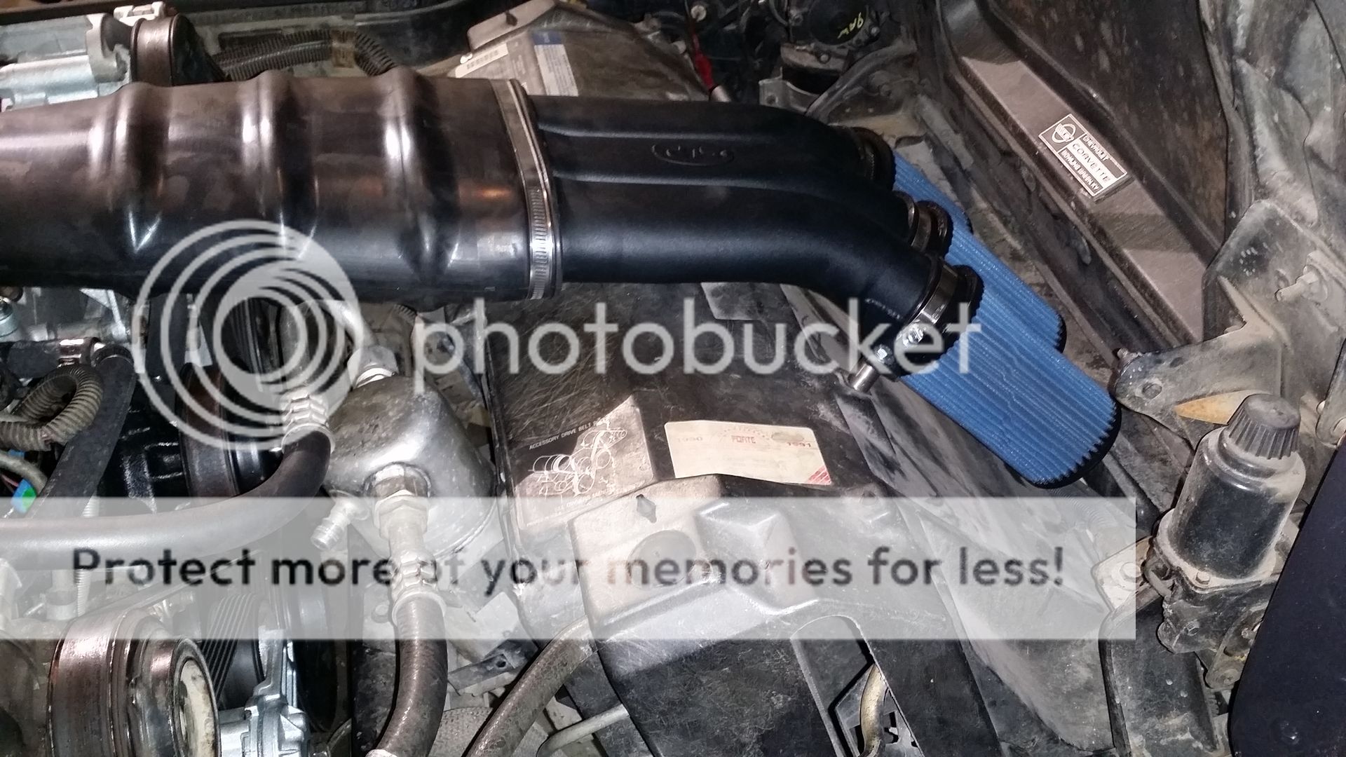

Not wanting my C4 clients feeling they have been left out here is a 1990 C4 we just finished up .

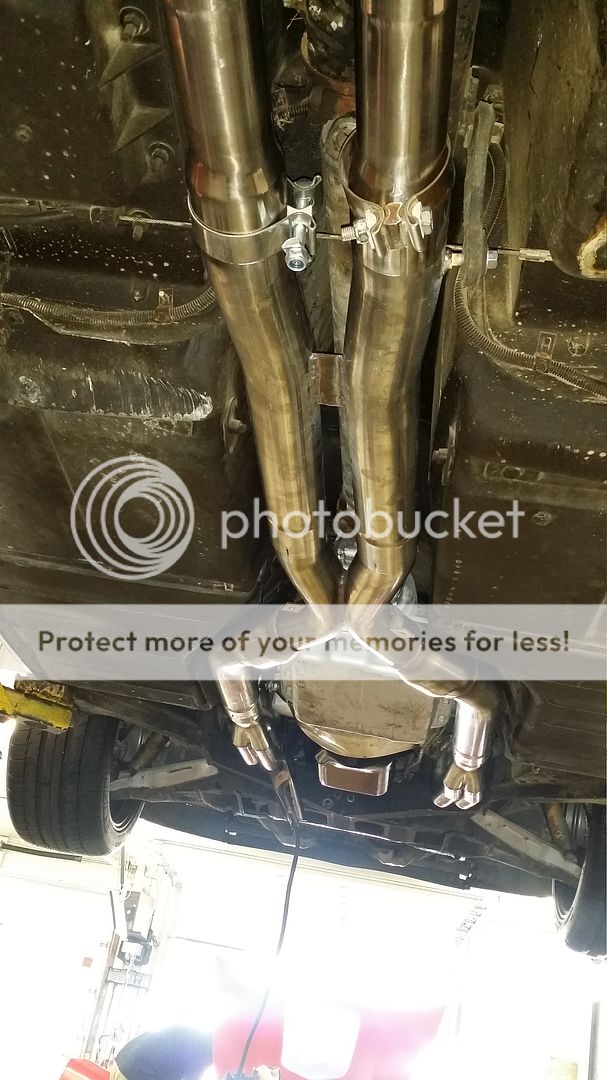

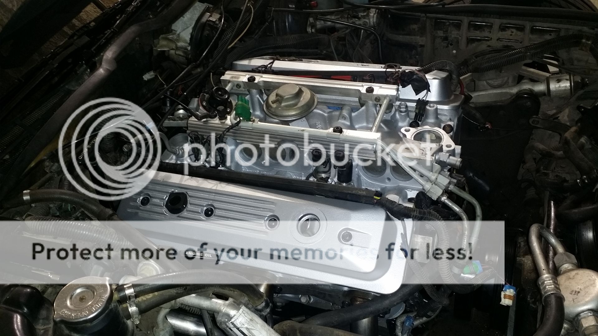

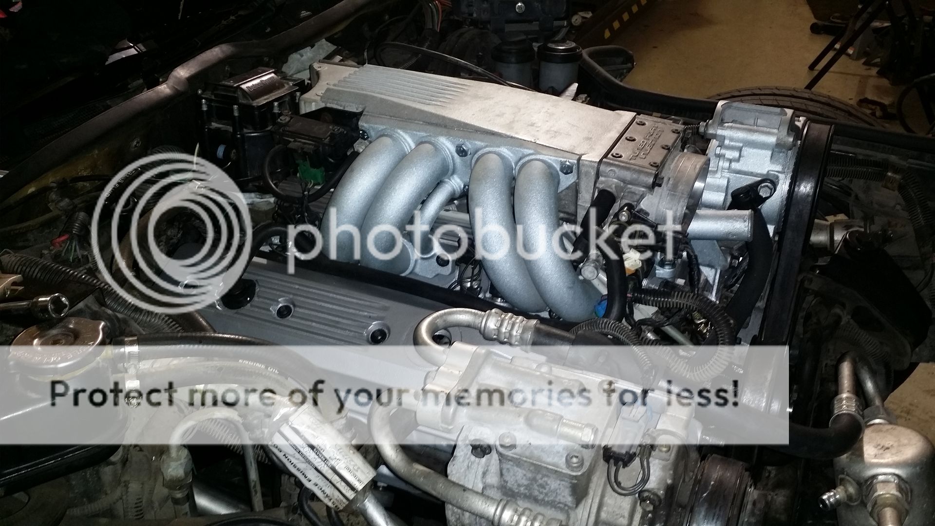

Rebuilt the L98 with a few goodies add in :
1.6 Rockers
LPE Cam
Comp push rods & double springs

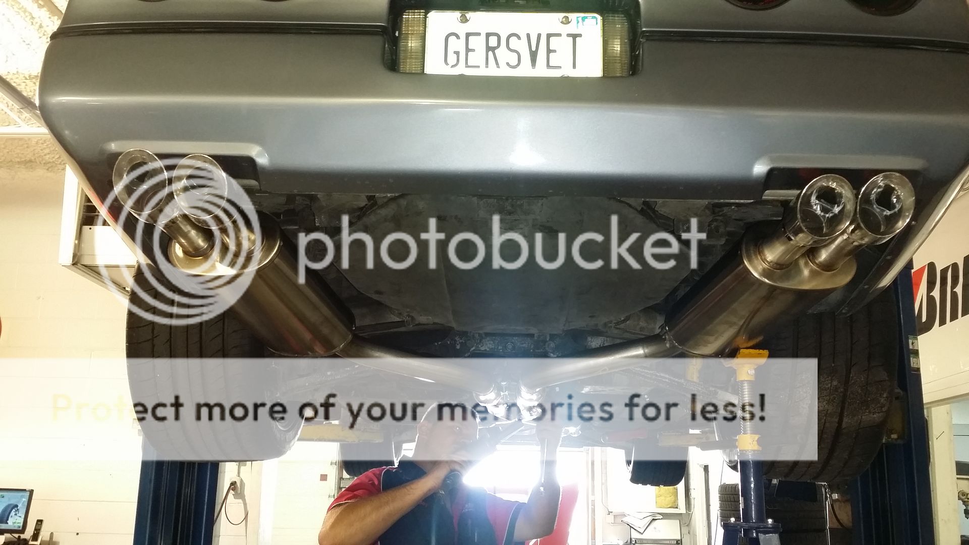

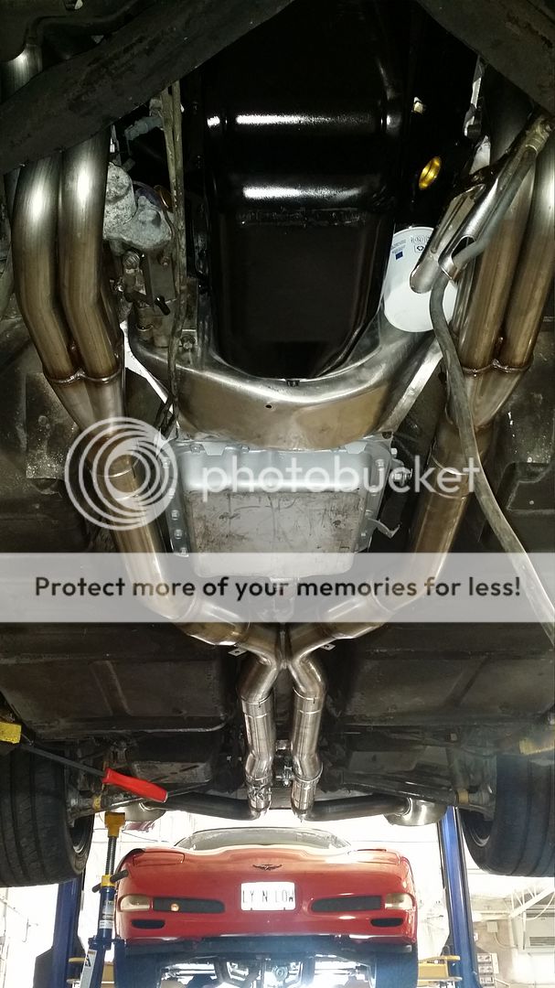

ARH 1 3/4" headers - highflow cats - x-pipe
Corsa Exhaust
Stage 2 rebuilt 700R4 + 2800 Stall
3.73 gears
SLP cold air and smooth coupler

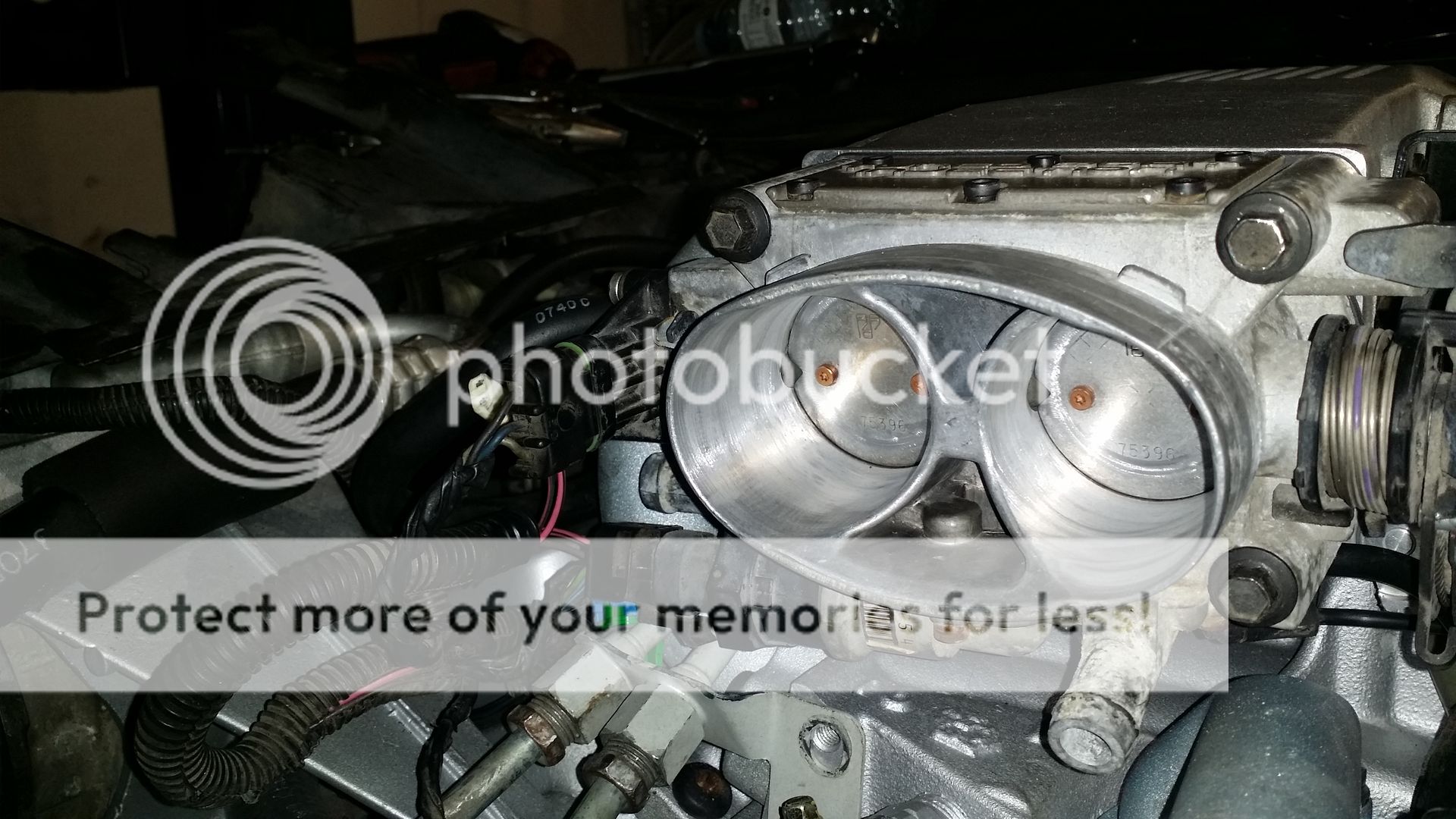

Ported and polished heads / upper & lower plenum and TB
TSW wheels + Michelin rubber
Lowered 1"

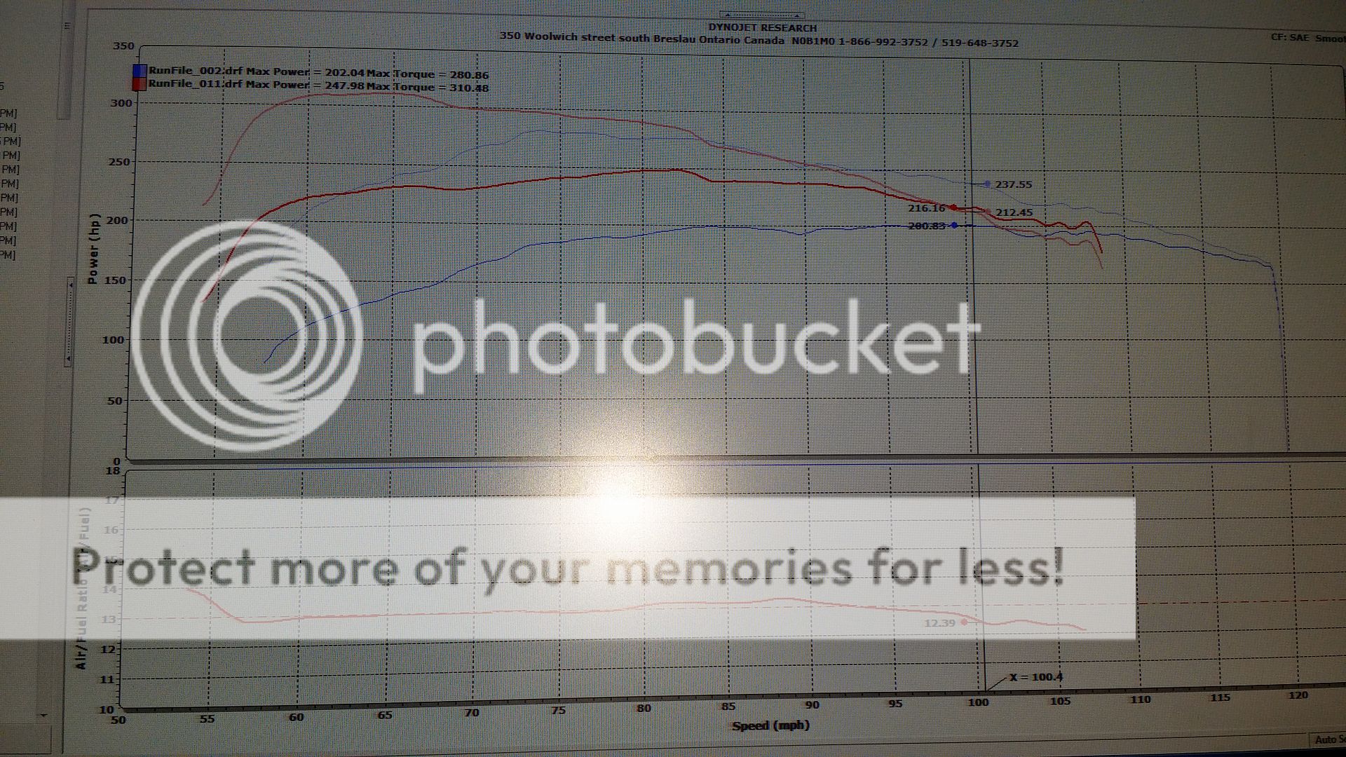

Custom Chip made in house
Baselined at 203 rw final dyno came in @ 250RWHP & 305 RWTQ
This was a fun build:
