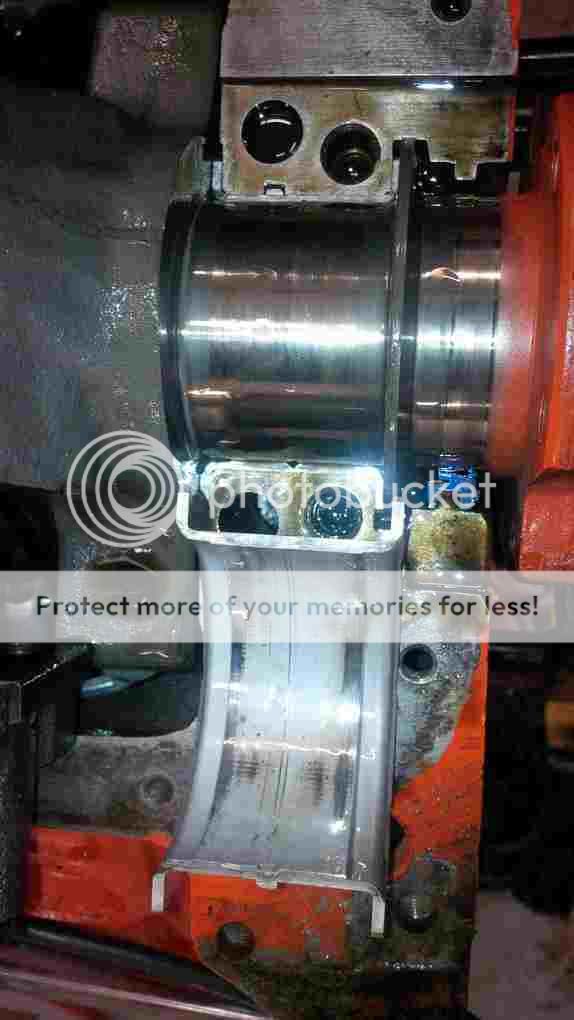

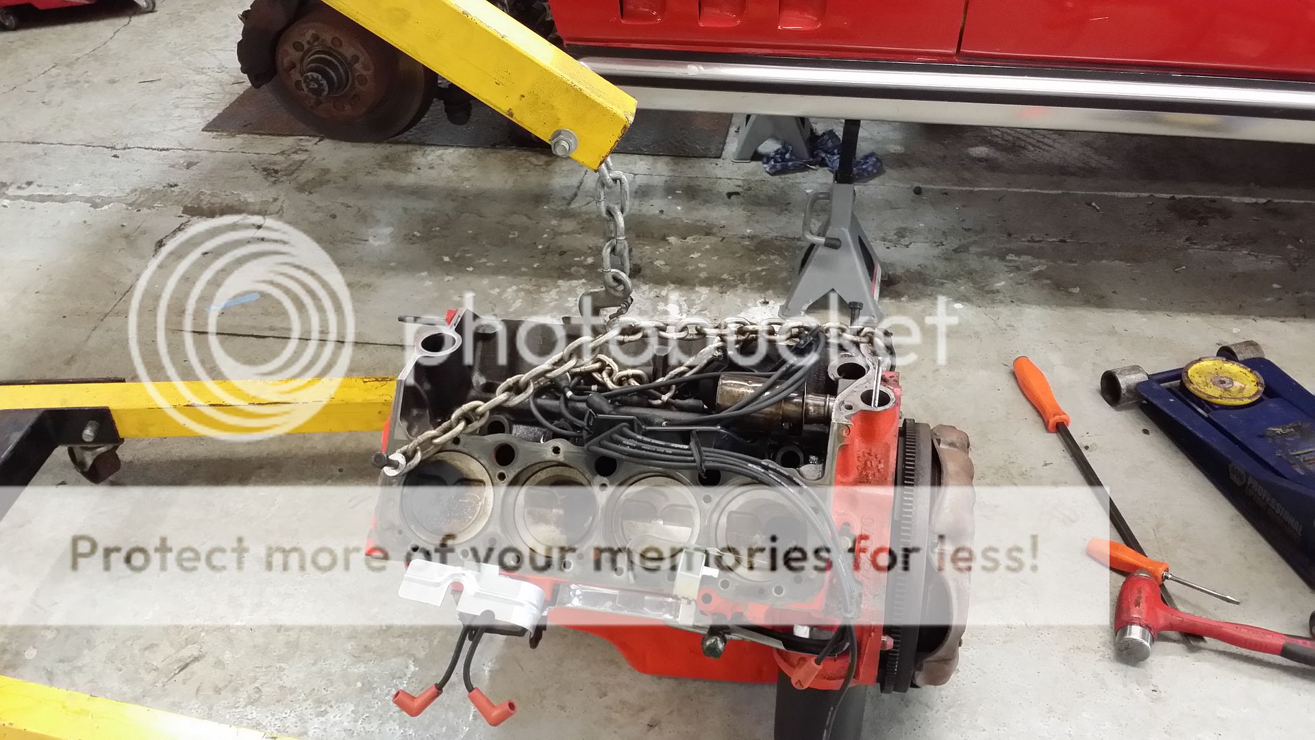

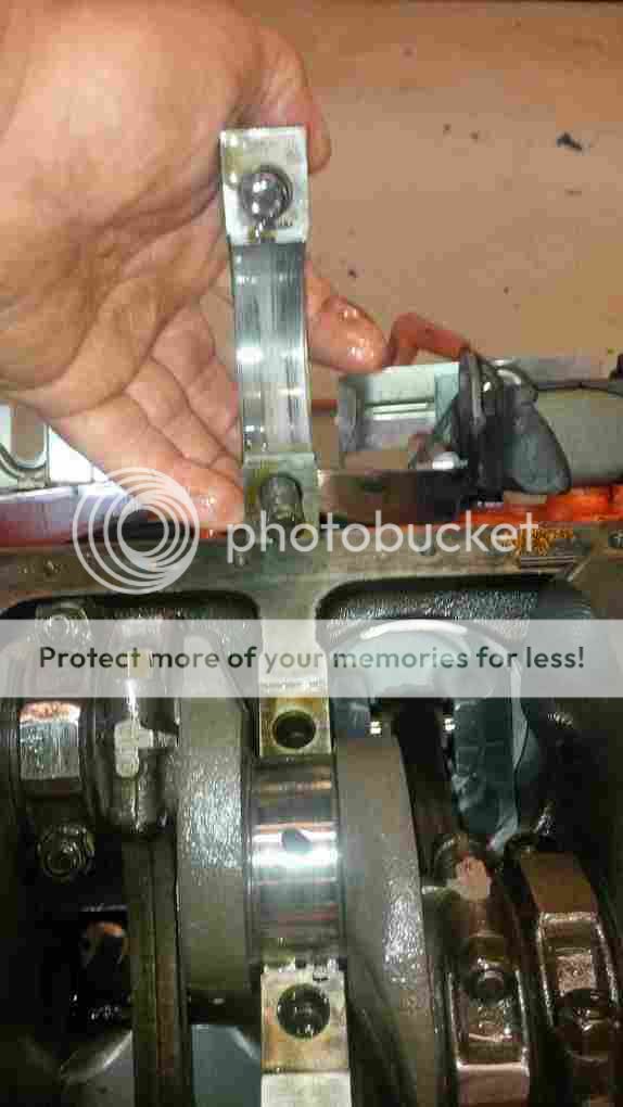

This customer came to Dasilva looking to just have the engined tuned as it was running poorly after being rebuilt .
We ended up having to remove the engine to do a complete rebuild .

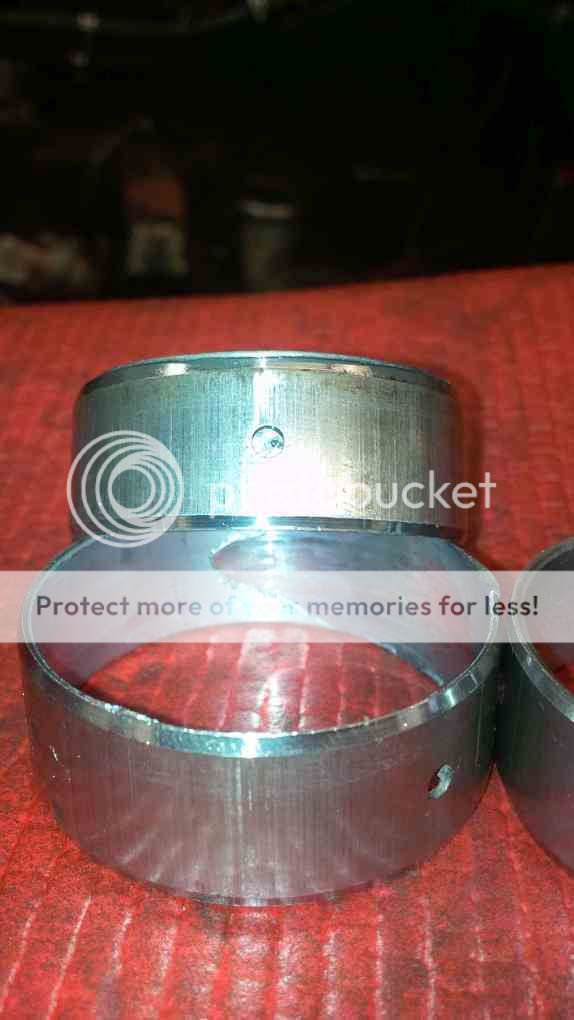

All the bearing were shot as a result of a poor build . We suspect that the engine was not primed properly .

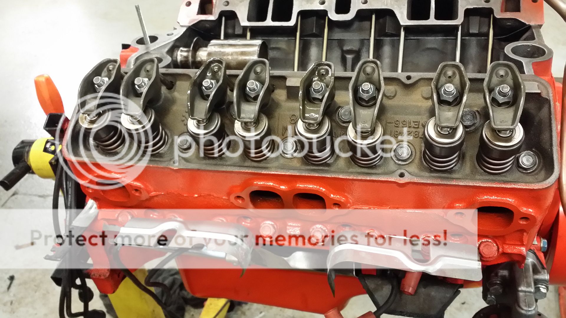

The heads were not even touched

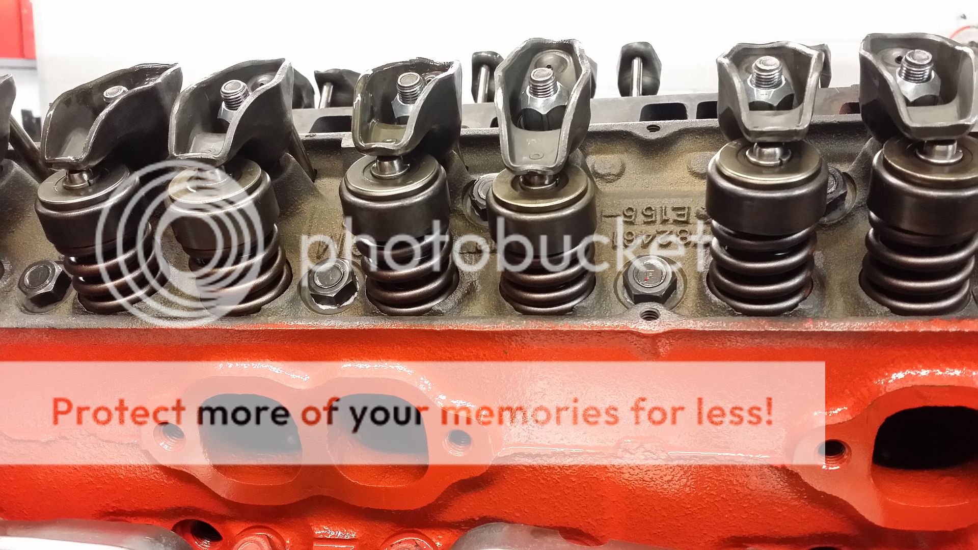

Here are the heads once we rebuilt them with fresh guides ,springs and seals .

Complete rebuild by Dasilva Motorsports .
