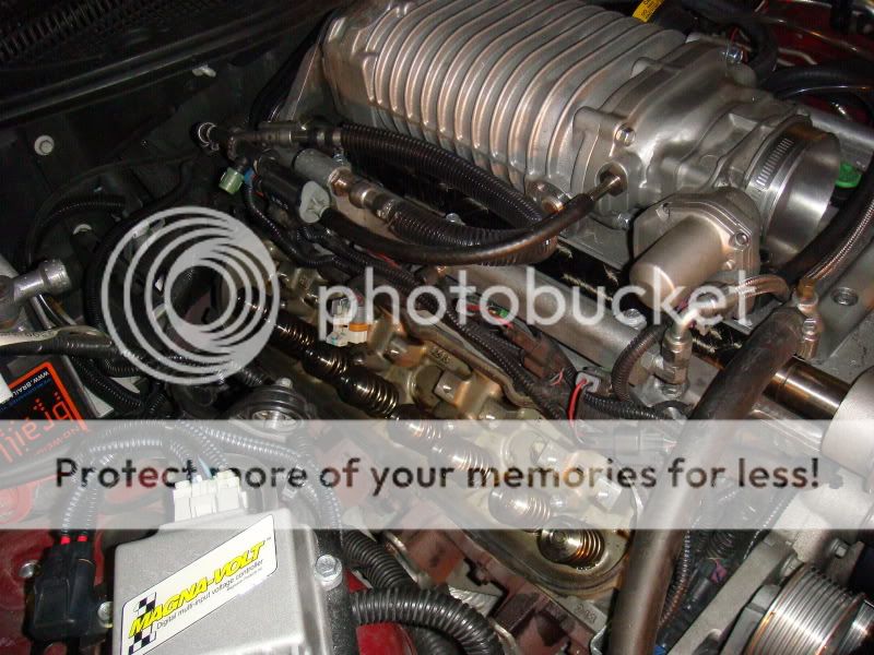

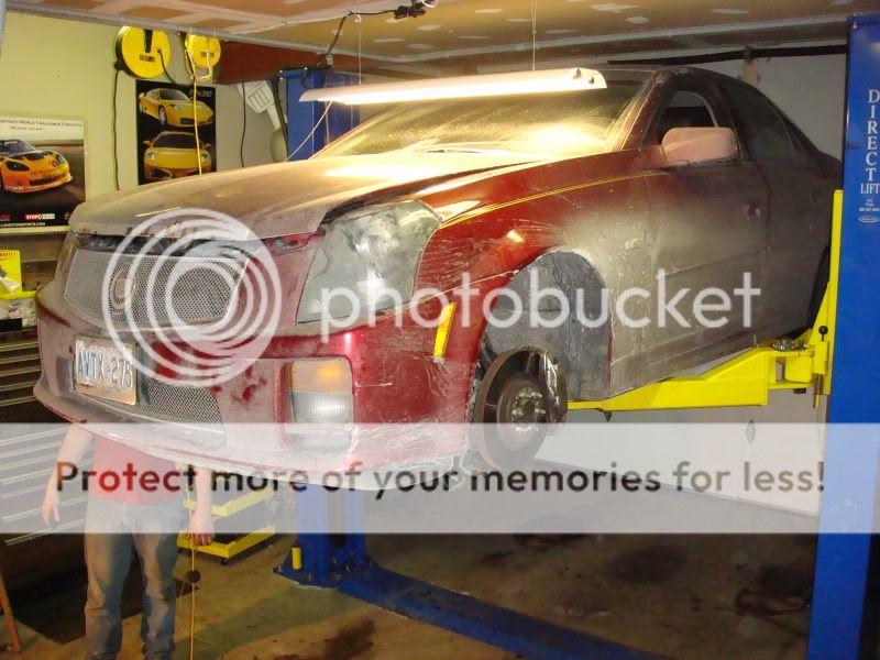

Well if your E.C.P, what else.............you put a cam in an 07 CTSV that you recently put a blower on :D

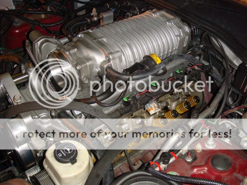

This is Nik's 07 LS2 CTSV with a Maggie and some other goodies. This week we installed an 8 rib belt pulley set-up, custom E.C.P blower Comp cam,Comp double springs,ti retainers , Comp push rods, Yella Terra Rockers ,JP double roller chain & gears along with a melling oil pump. Nice and this is a DD :eek::eek:
Here are a few pictures :
I told you it was a daily driver :rofl:
The old springs
The new springs

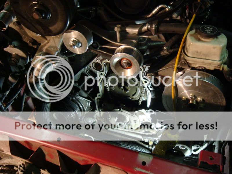

The new pulleys and the timing cover off
The old stick coming out
The new stick in as well as timing chain & oil pump and the Yella Terra's
More pictures to come later after we install the driver's side hardened shaft and fire this puppy up :canada:
